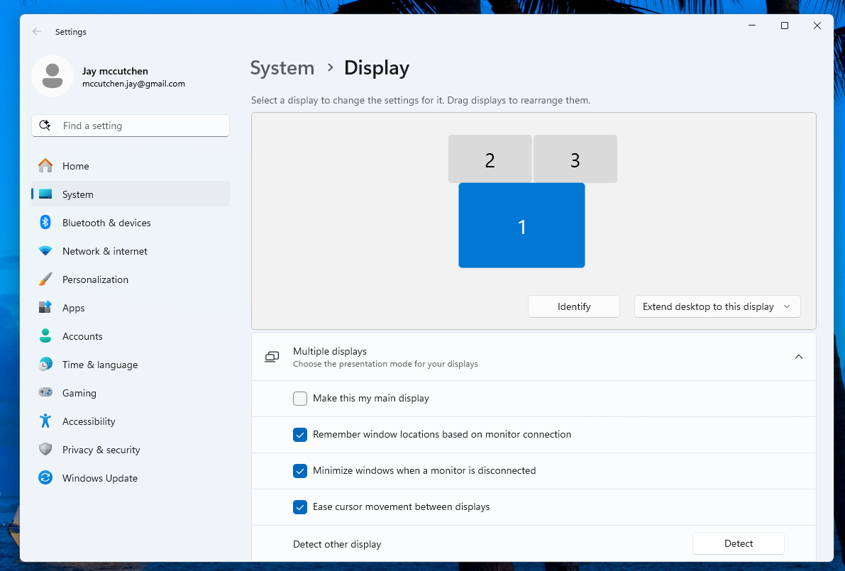

    Could you open the display settings and check if the external monitor is detected? (Please provide a screenshot.) Also, provide a complete connection diagram (including the HP computer, MODK1407 docking station, and monitor).

  • @jay mccutchen
    The monitor is not being recognized. Are you using MODK1407 to connect to an HP computer (HP ENVY x360 m Convertible Model15m-cn0011dx)?

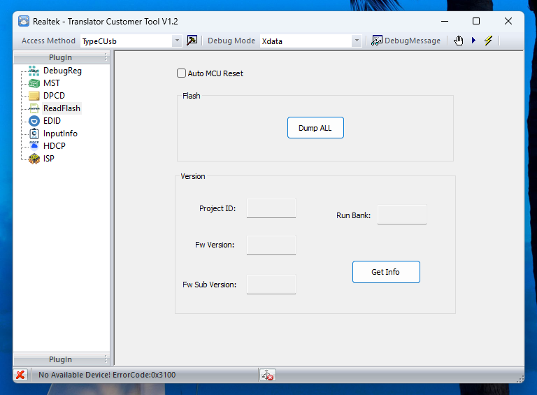

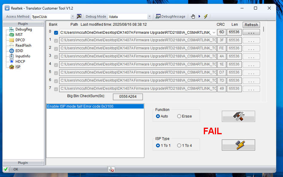

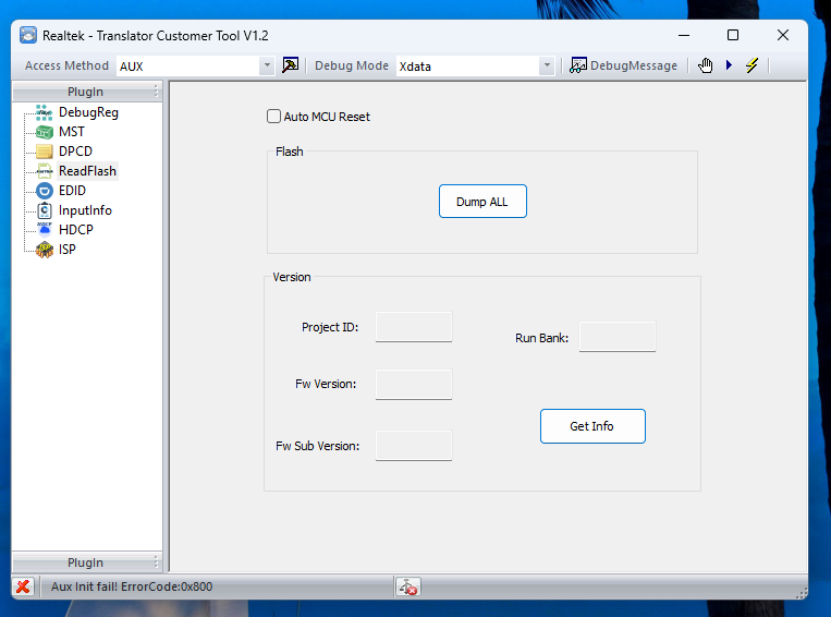

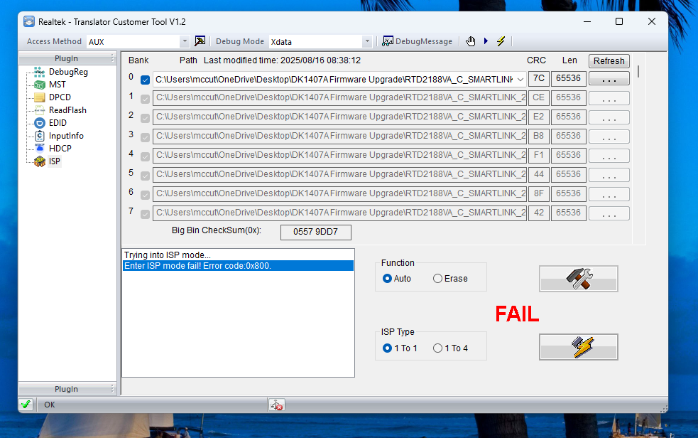

    Graphics card is up to date, manually checked. switched to surface pro that fully functions with the MODK1407 and used the upgrade tool. i tried both 2023 file and 2024 file and get a FAIL every time. this is all done on the surface that is fully functioning on all displays.
    when i switch back to the HP envy x360 this is still no function on the MODK1407 displays and HP Envy doesnt detect any other displays. below screen shpts are from Surface, i tried the AUX and USBC connection on the update tool

    From the images you provided, it seems the upgrade failed. Could you please try upgrading on your work laptop (Dell Latitude 5420)?
    Connect the monitor to the HDMI port on the docking station for the upgrade, not the DP port. Open the computer's display settings, and after it's correctly identified, begin the upgrade. Please follow the upgrade steps in the upgrade documentation.
    After the upgrade is successful, switch to the HP ENVY x360 m Convertible Model15m-cn0011dx to test whether the issue is resolved.
