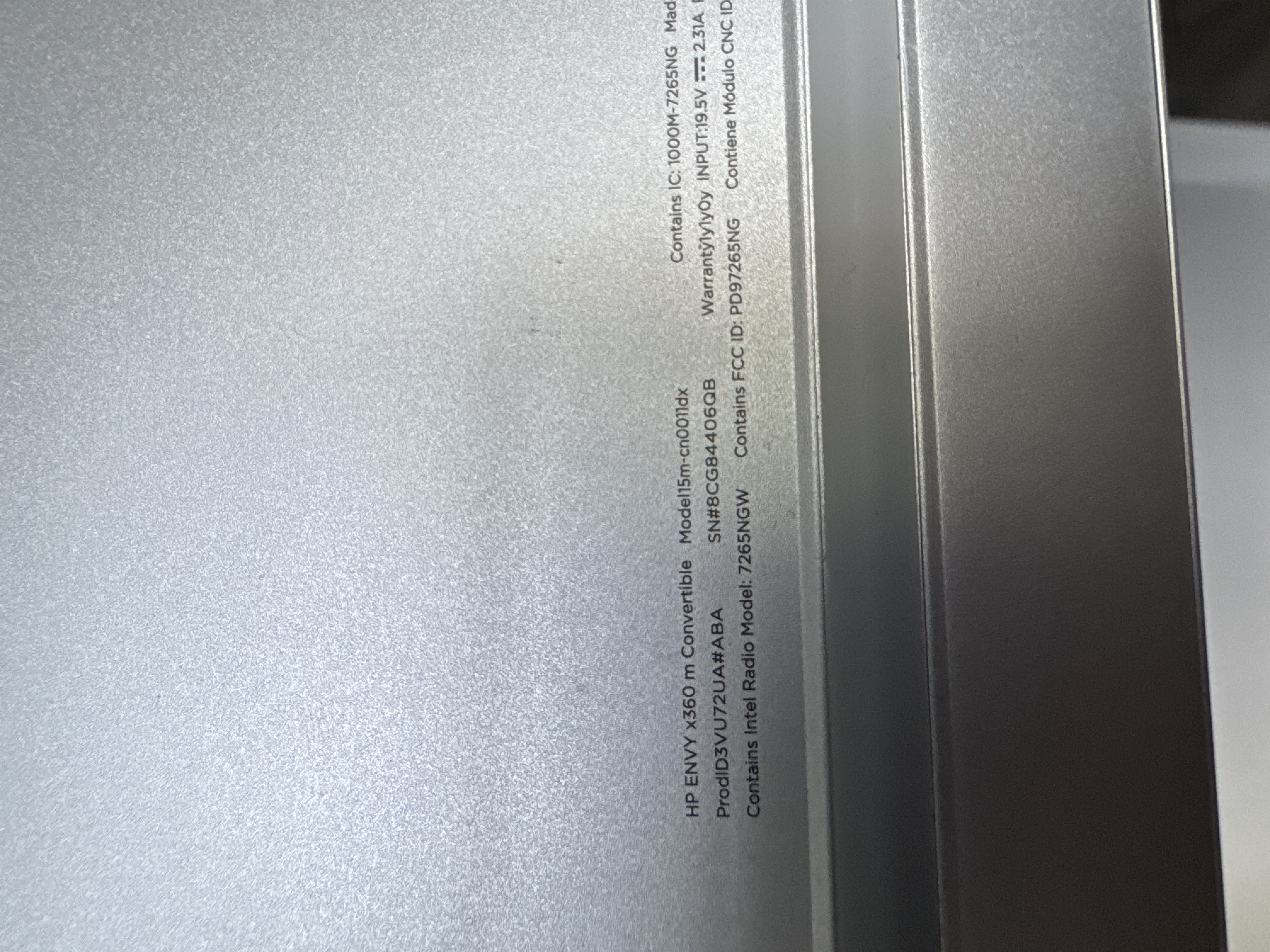

  • Hi @jay mccutchen,
    To better resolve your issue, please provide the Product ID (ProdID) and Serial Number (SN) located on the back of your HP laptop. You may also send us a clear photo of the label.
    Looking forward to your reply.

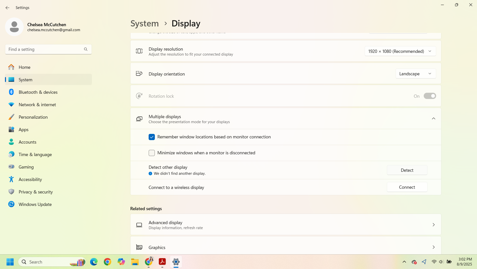

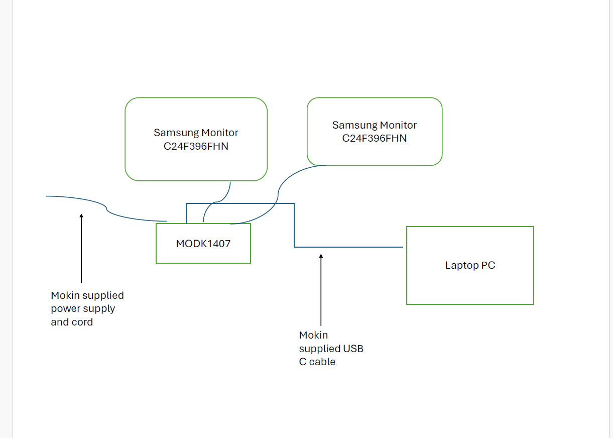

    Thank you for the information.
    Could you open the display settings and check if the external monitor is detected? (Please provide a screenshot.) Also, provide a complete connection diagram (including the HP computer, MODK1407 docking station, and monitor).
    Best regards
  • @jay mccutchen
    The monitor is not being recognized. Are you using MODK1407 to connect to an HP computer (HP ENVY x360 m Convertible Model15m-cn0011dx)?
